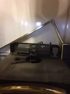

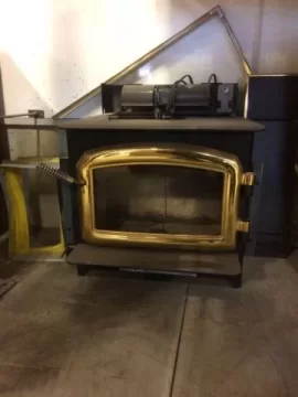

So I bought a regency i1200 for $300 from a contractor and I pick it up tomorrow. Looks to be near mint condition. I was told it has been rarely used as it was gifted to them by the contractor but the owners didn't like burning wood and decided to use gas.
I need advice on what I should inspect before coughing up the cash on this kijiji deal. can you guys help me with that?

Sweet!
I'm happy to see that you have decided to go with a proper heater!:)
I think your main things to look for on a used steel stove are cracked welds, warpage, and discoloration(orange-ish on iron, not sure about steel) indicating overfire. I'd also check the door latch, the air control lever, and burn tubes in the ceiling of the firebox.
If they have converted to gas, they may let you have the liner for this stove too...

Warped tubes, or any warped steel and cracks would be my biggest concern. Looks very good from the pics though. Cracked bricks are easily replaced but I don't see any. Doesn't appear to have been used very much. I think you got a deal on your hands
Yes sir I think I do. Looks like its price rang is $1,950-$2,750 and if his story is correct and I assume it is. It's brand new with only a handful of fires in it. $200 for the project I was thinking about or $300 and get closer to heating my home with wood. I am genuinely excited.
