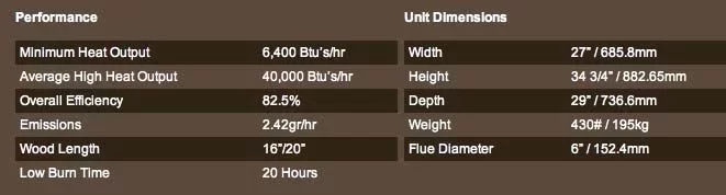

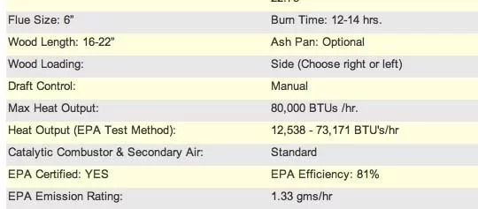

What I can't figure out is why these two stoves have such similar firebox sizes and efficiency ratings, yet they burn so differently. I would have considered the BK Princess, but it's a top-vent only and the wife also hates the looks.
All I can say is I loved my Fireview but the Progress is even better.
BK Princess----------------------------------------WS Progress
