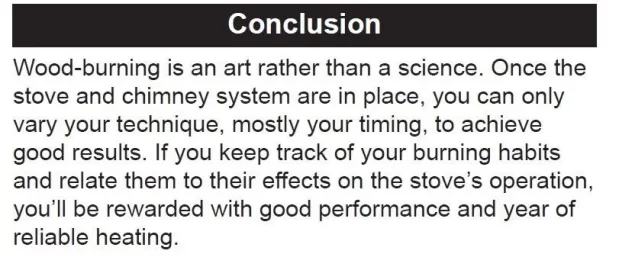

LOL!! Right from Vermont Castings manual: "Wood burning is an Art, not a science....." I LOVE it!!!!
