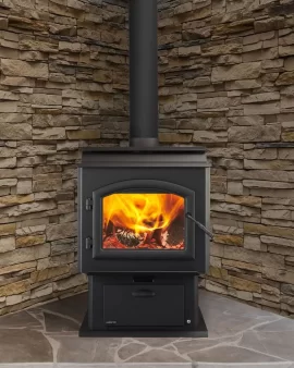

Adventure 3:

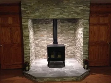

This is roughly the installation I am looking at, although the stove will be a much tighter fit:

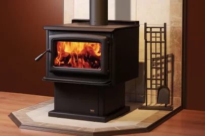

Pacific Energy Summit:

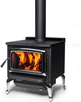

Summit with legs:

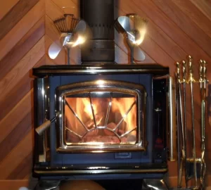

Here is my 1999 PE Spectrum Classic the Summit's little brother, it still looks like new and operates like the day it was installed 18 years ago.

Check alcove installation requirements for clearances for these stoves. Typical requirement is an 84" ceiling height.
