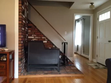

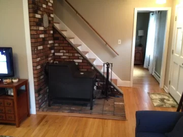

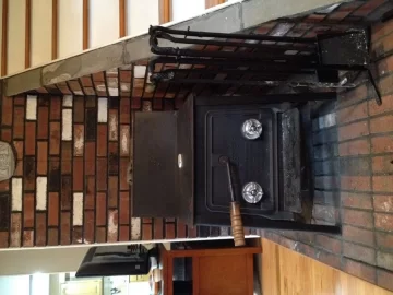

  • I'd like to be able to utilize the current hearth without modifying it if possible. Hopefully the pictures will shed some light here; the hearth measures 37" by 64". The current stove is installed facing the front door of the house rather than the living room. I'd like to install the new stove so that the front of the stove faces the living room and provides a view of the fire. Basically a 90-degree rotation.
My dilemma is that doing this will leave my choice of stove somewhat constrained by the depth of the hearth. Because of the configuration of the room, I'd rather not extend it out further if I can help it. I'm looking for recommendations of stoves that will fit in this configuration. Pouring over and trying to interpret spec sheets for each model has been tedious; so far I believe I've identified that the Hearthstone Tribute would fit, but that stove is really not big enough to heat my home. Are there any other options? In terms of preferences, I really like both cast iron and soapstone. I'd probably prefer a non-cat stove, but I'm open to both. Let me know if any additional details would help. Thanks in advance!

Hmm, I think the biggest issue here may be the low flue thimble. That really restricts options. If not for that I was thinking a Woodstock Fireview. It will side load on the right side, but requires a minimum hearth of 44"x 50". But this would require raising the thimble I think. The only EPA stove I know that is configured like the old Forester is the Buck 261.
If you can move up the thimble to say 5ft off the floor (where the A plaque currently is) and extend the hearth then your options increase a lot. The current hearth would need to be rebuilt but it doesn't need to be as high nor out of brick. If the new stove only requires ember protection, the new hearth area could be almost flush with the current floor or if slightly higher, framed with a gently ramped trim.
The hearth depth is going to depend on how the stove's firebox is shaped. For this area you'd be best off with an East/West firebox, that is one that is shallow and wide like that of the Jotul Castine, Quadrafire Cumberland Gap, Hearthstone Shelburne, Hampton H300, etc. Or in steel a stove like the Drolet Escape 1800, FW2700 etc.

Thanks for the ideas. Interestingly, that A plaque is actually hiding an old thimble through the brick that has been sealed with cement. Would re-opening this thimble be a huge undertaking? That's what I was envisioning, as the current thimble is, as you said, too low for most applications. If I went with a stove that required only ember protection, would I be able to put a fire-resistant hearth rug in front of the current hearth? Or would I need something more permanent?
Definitely just raise the thimble and get the stove you like that will do the job. I don't think opening it up would be too involved but someone else would know more.
I was hoping that was an old thimble. Yes, the cement can be removed and a 6" clay crock installed as long as there is not wood at all within 12". I'm not a big fan of rugs, but a fiberglass rug would be better than nothing. I would tack it down in the corners so it can't slip. Another thing that would work would be a sheet of metal. It could be copper to keep things dressy, or stainless steel. In that case it should have the edge folded over and it should be nailed in place with short nails. around the perimeter.

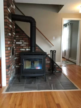

I thought I'd wrap this thread up with a happy ending. The Forester is gone, new hearth is completed, and the Manchester installed. We just had our first couple break-in fires yesterday, looking forward to letting her rip later this week when the temperature drops a bit. It's a new feeling looking forward to cold weather! Thanks to everyone here for all the very helpful input.

Nice install. That's a great looking stove (just missing the fire ;) ).
Over the weekend you will have chance to try that bad boy. Looks good.
Looking real good! That should be a major improvement.
Very nice! :cool: Looking forward to updates once you've got 'er broken in and running.
