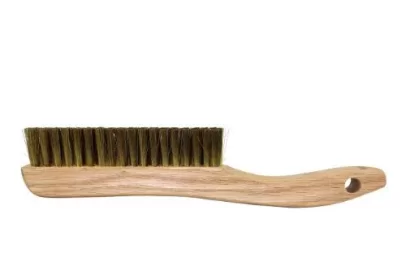

I have melted my share of brushes after a while...i get HD cheapies now.
I do that with the stove running too, in between real cleanings. I just did it a few days ago, maybe again tonight. My two week cleaning is next weekend. On these quick cleans ( while running) you do have to turn the stove down for a few minutes, it melts nylon bristles otherwise and you gotta be quick at that. Lets put it this way, I'm not ever painting with that brush !
I use the cheap boar's bristle brushes (china bristle) - those don't melt up like the nylon brushes do.
I've considered the china bristles and am glad to hear they work. One guy here a couple of years ago was on a search for a brass or copper brush, I don't know how he ever made out. The only metal ones I'm aware of are the wire type but the handles all would be inconveniently directed for getting at the heat exchanger.
Like this: [Hearth.com] Help me understand my Harman P68 settings
Thanks for the tip, I will have to try one also, like others my Nylon one isn't looking so good, it's having a real bad hair day. Good to hear this is an option to try, also like the suggestion to let it cool for a few minutes first. I really agree that keeping those sides and heat exchanger baffles clean helps with heat transfer. Good ideas, much appreciated!
