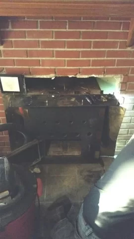

Hello, I have a wood stove insert that is not drawing up. I have owned the house for about 5 years, house is 21 years old. I bought house from original builder, wood stove insert is primary source of heat and installed then. No furnace in house. Wood stove heats house without problem. Went to start first fire and noted no draw up. Concluded it probably is related to creosote build up. I called on chimney repair, stated unable to clean it bc of the way the woodstove insert design is with tubes, unable to assess to clean. Not sure how was cleaned in past, I don't know model or make of insert, trying to figure this out, any help? Also trying to figure out if able to remove insert safely with out problems to clean.
[Hearth.com] Help, model/make of wood stove insert & draw up problem

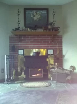

Looks like some sort of zero clearance fireplace.
I have been searching, trying to find similar unit, haven't found one yet.
I need to try to find way to clean it, are u able to pull these out, no access to remove debris from unit bc of tubes.

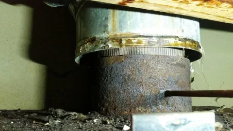

this is the top of the unit. I cant tell if I the pipe is holding up weight with chimmey or if pipe is cut will cause problems.
OK, it's much clearer with the wider shot. Looks like a ZC with an air cooled chimney. I have to say that a hot flue collar that close to wood is not looking safe and the flue collar connection looks very loose. You might want to have a professional csia sweep inspect this setup for safety first. www.csia.org

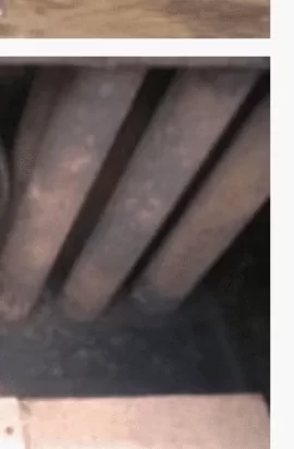

This has been used since house was built. No problems until this year. Now not able to use until i am able to fix it. I had professional sweep company that DX problems ( from that site) insect this week and they were unable to guide me much. Basically stating creosote build up was the problem with no draw up. Fix: was to clean, however They cant assess wood stove to clean bc of coils. I attached photo. They quoted me to replace complete chimmey and pipe related to needs area to assess pipe to pull wood stove insert out to clean out. He tried several attempts to get around coils to clean out but unable. Now need guidance if able to remove insert to clean out with pipe installed?
Appears maybe no bather because of coils?
Kinda crazy no Easy way to clean.
ok that looks to me like a home or local shop made insert that is installed like a zeroclearance unit. I honestly would not use it untill the entire system is completley evaluated for safety. I see some major red flags and the fact that it cannot be cleaned properly is a big problem also
