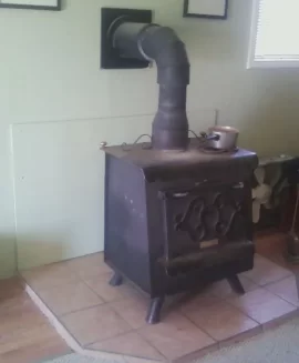

  21. Hoozie
    Hoozie
    Burning Hunk 2.
    Sep 30, 2012
    209
    44
    Klamath Basin, Oregon
    Hmm, the Isle Royale also looks quite nice. And a similar price to the F500.
    Attached are a couple pictures of the current setup. I'd like to fix it without tearing into the wall, but I can do that if I have to.
  22. begreen
    begreen
    Mooderator 2.
    Staff Member
    Nov 18, 2005
    65,254
    8,740
    South Puget Sound, WA
    Cripers, another problem with the current setup is the reduction to 6" then back to 8". Unfortunately that 8" pipe is going to be a further draft reducing complication.
  23. Hoozie
    Hoozie
    Burning Hunk 2.
    Sep 30, 2012
    209
    44
    I know the 8" to 6" right at the stove doesn't help, but everything else is 6" ID. The inside 90* looks to be double wall, and I think everything beyond that is triple wall. Just measured the pipe in the outside 90* just to make sure.
  24. begreen
    begreen
    Mooderator 2.
    Staff Member
    Nov 18, 2005
    65,254
    8,740
    If it is 6" outside that's good. Check the pipe label if unsure. The Tee support outside is bogus. It looks like the pipe joint on top is stressed from the tee sagging. That needs a proper tee support from the manufacturer. Are there any more shortcuts taken on the chimney besides the poor tee support and too short chimney?
