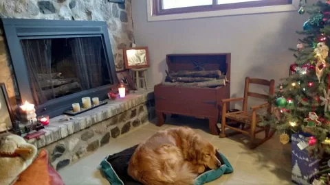

Hello I have lived in my home for 8 years and never had a fire in the fireplace. I was recently given a used Avalon pendleton insert. My wife would love me to install but. I'm not sure where to start. It is a brick chimney. I know I need a liner but not sure what. Thank you for your time and help

Welcome. The first place to start is to have the chimney inspected and cleaned if necessary. Then download the Pendleton manual if it didn't come with the stove. Are you considering self-installing or having it installed?
