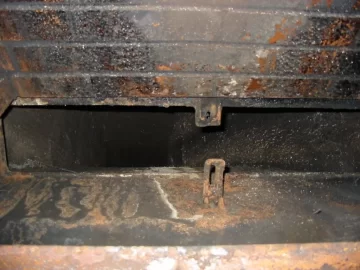

Hi. I was wondering if someone could tell me how to remove the entire damper in my masonry fireplace in preparation for converting to a wood stove. I've got the door off now but I want to take the whole assembly out. Are they usually just set in there or is there some sort of hardware holding it in. I can't seem to find anything holding it. It seems to be in there pretty tight...I can't budge it. Granted there's some creosote deposits that likely have it glued in a bit but anything else likely to be holding it other than the lips and gravity? I'm sure i could get it out, but I'd like to get it out undamaged in case I ever want to put it back in....i.e I sell the house and want to take the stove with me.
I'm attaching a picture of it.
Thanks in advance for any help.
Darryl

If I am seeing right, it looks like the damper (the door) has already been removed. I don't think one can easily remove the damper throat. It is usually permanently installed. Normally one ovalizes the liner to fit or cuts/grinds out clearance at this point. If this is a 2 story chimney, you could probably go with a 5.5" liner to reduce ovalizing.
should you decide to cut, I found a cut off wheel worked best. Sawzall just made a mess and ate up blades.
I just cut a big "V" notch in one side of mine, and it worked fine. Get a reciprocating saw with a blade long enough to cut through both the face (which you can see) and the top shelf. Plan the angles of your cut with care to avoid cutting twice. It's a bit of a pain, but you can do it.

Not contradicting, but for the record; the sawzall went through mine like butter. Most of the work is in getting setup to go, and also, be prepared to get real sooty.

I would cut it and use a 6 inch. I figured I could have mine welded back together if I wanted to put it back to original.

I tried my sawzall and that didn't work well. The cast iron was way too tough.
Used my handheld grinder and cut the damper frame out in a matter of minutes. I guess I could have used an oval connection, but I wanted the 6" round all the way from stove to chimney top.
