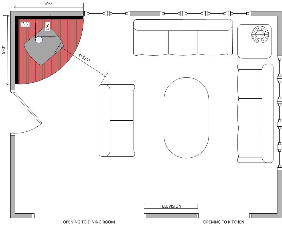

I'll post a sketch tomorrow, but I'd really prefer full bricks...they just provide a more substantial profile for the mantle to mount on. I'm thinking something like a granite mantel shelf 1.5" - 2" thick with a rough edge. I'm certainly hoping that a brick hearth will minimize the amount of space required between the stove and the wall. The Isle Royale in the Quadra-Fire literature is like 6" from the wall. I'm just trying to figure out what the recipe is for a noncombustible wall surface...a sheet of steel behind the bricks? The chimney will be going straight up and through the ceiling.

No problem, full bricks can work. 6" is the minimum corner install clearance using a double-wall connector pipe. That would be the same if the wall was brick or sheetrock. It sounds like brick will give you greater peace of mind, so go for it.
Single wall pipe must be at least 18" from the wall. In the case of the IR corner install that requirement trumps the closest corner clearance. Double wall connector clearance is 6", but there is no way in a corner install that the vertical pipe can be 6" from the wall. In this case the 6" corner clearance represents the closest tested safe distance for the back corners of the stove. That said, remember, there is no harm in exceeding minimum clearance requirements.

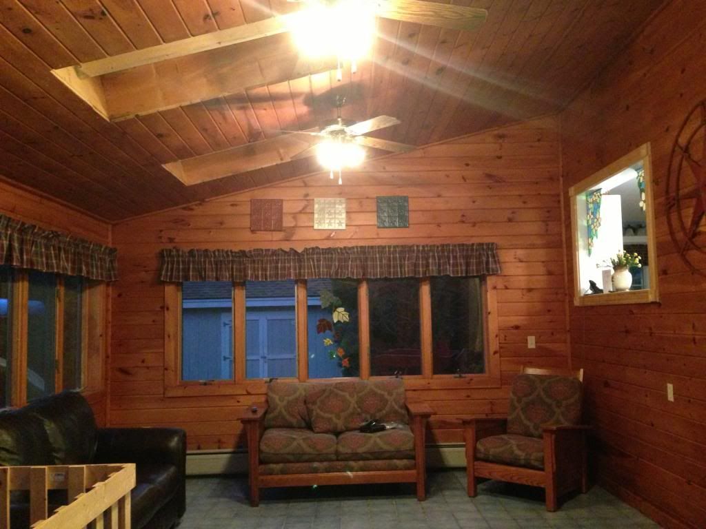

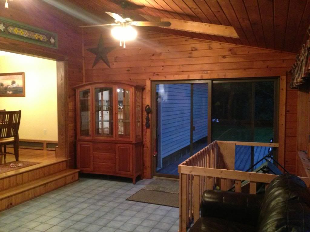

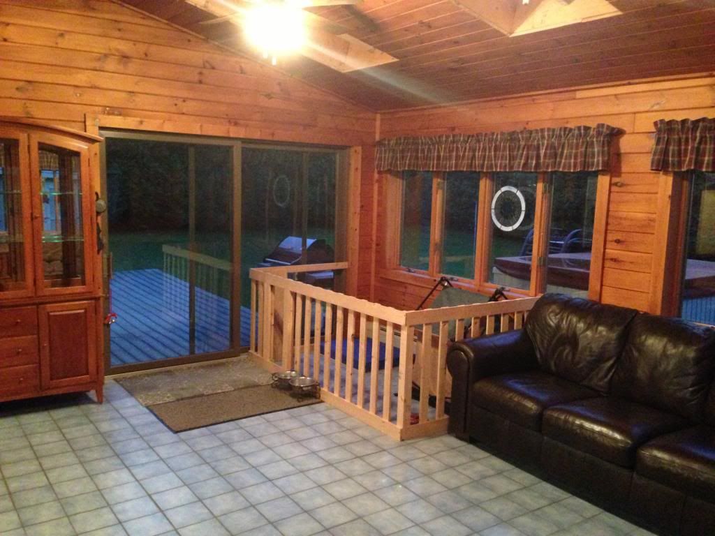

My house is an 1800 sq. ft Colonial...25 years old...well insulated and generally pretty tight. I have a room addition on the back of the house that's 20x16 with cathedral ceiling that peaks about 16'. Its wide open to the rest of the first floor.
