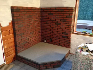

Busy night...last night. I've been looking at the bluestone slab for a few days now and really wanting to move forward with the installation. Lining up and extra body or two to put it into place has been proving problematic due to work schedules. So, during a moment of weak judgement, I decided to attempt it myself. With the slab still on edge, I lifted one corner and had my daughter slip a piece of round 1/2" bar stock under it. This allowed me to roll the slab the remaining foot into the corner of the hearth. I wasn't exactly confident in the precision of my brick work or the cut of the slab so I really wated to dry fit it before even considering mortar. Besides, I wasn't even sure that I'd be able to shift it into position once I laid it down. Mortar wouldn't help that situation. So, having positioned a cardboard box on the hearth to cushion the impact if I wasn't able to hold up the slab, I attempted to lower it into place. The first 45 degrees went pretty well, but the transition from lifting above the waist to below the waist was a bit sketchy. I was able to support the weight so I had my daughter pull out the cardboard box and I was able to lower the slab gently into place.
[Hearth.com] Help Selecting A Quality Stove
After some pushing and pulling, I was able to get it tight up against the brick and looking pretty good. So good, in fact, that I thought I might just skip the mortar all together and leave it right here.
Thinking this might just be good enough...I stepped up onto the slab to see if it was resting solidly. Unfortunately, it noticeably rocked from front to back as I shifted my weight. "Surely it won't rock once I put the stove in place" I thought to myself, dreading the idea of lifting the slab up again. Then I laid on the floor to look at the fit between the bottom of the slab and the 3rd course of bricks on the front edges. I didn't like it; a 1/4 to 3/8" gap with no mortar was not great to look at. Of course, you'd have to lay with your face right on the floor to actually see it, but being an anal retentive nut job, it just wasn't going to work for me. The slab would have to come back up. The good news is that the rear edges of the slab and the brick walls mated up nice and tight.
So I summoned all of my strength, and like the middle-aged Olympian I imagine myself to be, I picked the slab up and leaned it against the wall. The crowd went wild!
Out into the driveway in the black of early evening, I set about mixing up a batch of mortar. I dragged in my mortar board and whipped up about 20 perfectly shaped turds of black mortar. I then positioned them in a continuous line on top of the 3rd course of bricks to ensure a nice joint and then in 10 strategic positions across the cinder blocks. Once I had used all 40lbs of mortar, I jumped up to drop the slab in place before the mortar could set. Confident in my ability to actually support the weight of the slab, I was able to lower it with much less fanfare this time. Once lowered, I scooted it into the corner and made sure that it was tight against the brick faces. Then I put the 4ft level on it and set about smacking various spots with the big orange deadblow hammer to get it level. Unfortunately, the surface area of the slab and the volume of the mortar under there seemed to render my hammer useless. The slab wasn't moving. Fearing that the mortar was drying and I might end up with a crooked slab, I went to the next bigger hammer at my disposal...me. I used the level to find the high spot and then I jumped up and down on thethat spot until it came down...move the level...jump up and down...level...jump...repeat.
In the end, it was just about perfectly level in all directions and completely solid...no rocking of any kind.

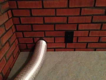

I went outside and used a block of wood to push the 4" pipe for the Outside Air Kit back into the house (I had pushed it out so it wouldn't obstruct the installation of the slab) and then I installed the flexible feed tube which will connect to the beack of the stove. I also installed the power outlet. I'm not 100% sure that the outlet won't melt, but I figure I'll give it a try. It's in a solidly grounded metal box so the risk is low and I can always put a metal blank cover on it later if it proves problematic.

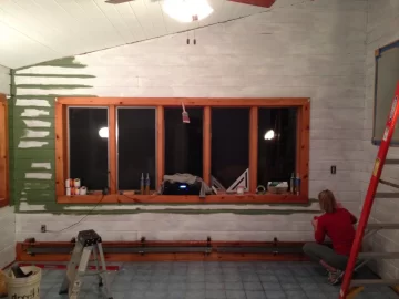

Riding high from my success with the slab, I decided to start painting the walls last night as well. Wife came home and joined in the fun.
I'm sure some folks are cringing at the idea of painting over the knotty pine in this room, but we've been looking at it for alot of years and we're ready for a change. On top of that, I'll be installing a hardwood floor in the next couple of weeks and it just seems like too much wood...like wearing blue jeans, a denim shirt, and a denim jacket...sometimes, its just too much of a good thing. We didn't want the room to feel like the inside of a shipping crate.

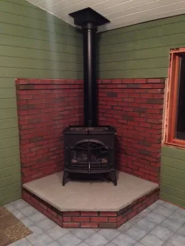

My boys showed up promptly at 8:00AM and I had already been prepping for a while. The plumb bob was hung from the chimney pipe and I had plywood protecting the brick face and the slab so we wouldn't mark it up during the move. The 3 of us were able to pick up the stove and set it perfectly in place in about 60 seconds. They took off and I installed the chimney. I think I'm actually ready to start a fire. Unfortunately, it's just too warm and it's been raining outside most of the day. I don't want to cook us out of the house. I'm hoping the temps will drop overnight. They've been threatening us with 2-4" of snow tongiht.

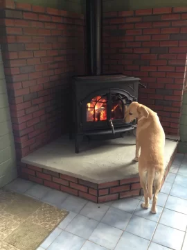

So I lit up the stove this morning with a little bit of kindling just to see if everything was tight...

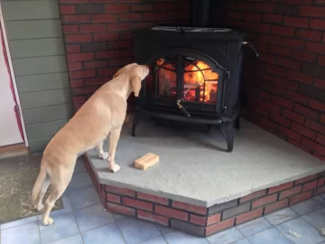

The dog showed up within 2 minutes to see what I was up to...
Reactions: newbieinCT
Apparently she approved as she promptly climbed up on the hearth and parked her butt without any encouragement from me.

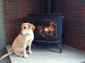

I figured I would let it burn for a while and then let it go out. That way I could burn off some of the new paint and the coating of oil and paper on the griddle surface. It certainly made some smoke and I had the windows open for a while. I used a putty knife to scrape the oily paper off of the griddle and then I used a brass brush to scrub the surface clean. I had heard that I should have a series of small fires and heating/cooling cycles to break in the stove, but the owner's manual said nothing at all about a breaking-in process. It basically explained the controls and set you off to make fire.
Everything seemed to be working just fine so I loaded a couple more pieces of dry pine scrap just to see what would happen.
My daughter and the dog sure seemed happy.

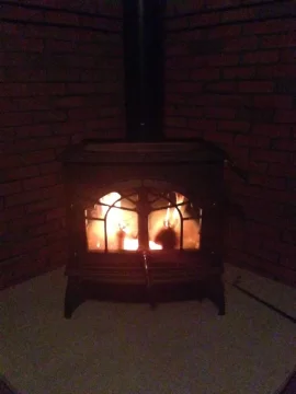

Riding high on my furniture store triumph, we did a little Christmas shopping and didn't make it home until about 7:00PM. We had been gone for 5 hours so I was pretty sure that the fire would be nothing but a few ashes at this point. I walked in the front door and was smacked in the face with a wave of warm air...much warmer than ever before. I came in and found my mother and daughter camped out on the floor by the hearth...along with my silly dog. The fire was burning strong as my mother had been feeding it while we were gone. The room with the stove is a perfect 80 degrees and the rest of the first floor is in the neighborhood of 77-78. The ceiling fans are on high and the entire place is straight up cozy. The house has never been this warm in the month of December - never.
Apparently, my mother, undaunted by the new equipment, managed to bring in some wood and get it into the stove. I noticed the glass is smoked up a bit, but otherwise everything looks just fine. She's clearly on board with the new arrangement.
So here I sit in the dark...in shorts and a t-shirt...typing away on the laptop and enjoying the flames dancing behind the glass...sipping some Jaegermeister Spice stuff that I just found at the store. I'd really like to thank everyone who contributed to this exact moment over the last month or so...helpful information...encouragement...varied opinions...vendor information...everything. I couldn't be happier with the results.
