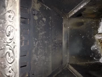

Looks like the old inserted burner is almost as old as the fireplace. I'm wondering if this possibly was set up for coal burning? Seeing the inside and the grate would be helpful.
To answer your question, this may be a situation where the wood being burned is not fully seasoned. You might try a modest fire with some cut off carpentry scraps. If that burns much better and without the smoking, then the wood supply is suspect.
Begreen caught it - that is a coal basket in the fireplace. The flue may not be large enough to handle the greater exhaust volume of a wood fire and coal flues typically did not have the smoke shelf that helps with drafting a wood fire.
Dry wood, cut up into small peices that fit the basket but even so you might not have good results.

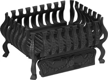

Hi Brad,
I think begreen may be right in that this style of fireplace is mostly used for burning coal, have one similar in my bedroom.
Usually when burning wood in an open fireplace they use a firebasket similar to this -
[Hearth.com] Help with an old fireplace
Hope this helps.
Billy.

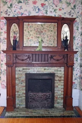

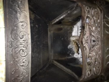

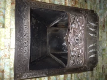

Thanks - I'll take some more pictures of the inside tonight. The wood is quite dry, it's been split for two summers - covered as well.
Here are the other pictures, they aren't the best but the lighting is difficult at this time of year.
