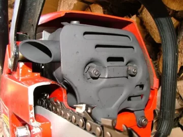

Heres a little inspiration......

mdfisher that's one wicked muff. do you happen to know if any other two-piece husky mufflers will fit my 455?
tanks papa. I'll check it out if theyu ever come back online
No I do not, I have an older 55 rancher which does most of my cutting I haven't had to take apart any 455's. Theres a guy I called about an aftermarket muffler (like the photo above), but for the lift of me I can't remember his name, I want to say he was out of Canada and he would build them for you. I do remember that he was not cheap!
