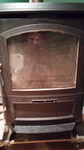

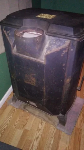

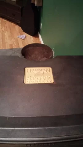

Hi all, first post here, so I'm sorry if wrong spot. I recently purchased a used harman wood/coal stove. However, the ID plate is missing, and I can't find the model ANYWHERE. I need specific installation guidlines , but it's impossible without the id and model number. Posting pics in hopes someone may know or point me in right direction. [Hearth.com] Help with model of harman wood stove [Hearth.com] Help with model of harman wood stove

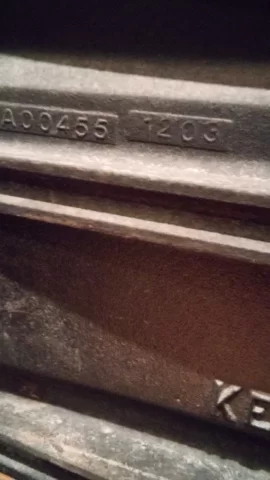

Kind of looks like a pellet stove. In the picture that shows the cast letters KE, what does the rest of that say? What size is the flue outlet? Is there a UL label on the back of the stove that lists the model?

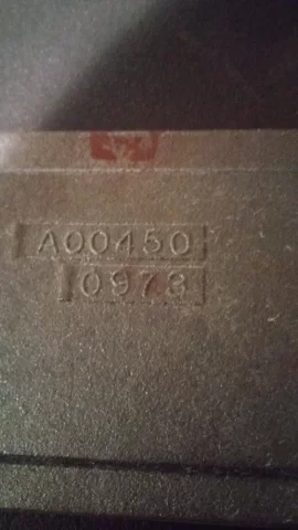

It says " keep door closed". Its 7" diameter. The numbers on the inside door don't match the numbers on back of gold harman logo plate, worries me

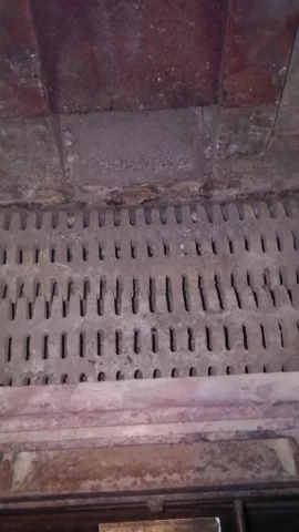

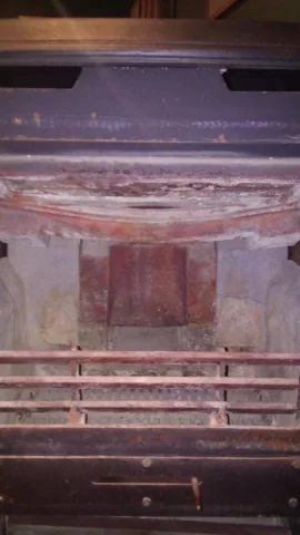

Show us pics inside the stove. You need to be aware that if the ul tag is missing it is a non listed stove regardless. So you would have to go to the 36" clearances. Unless you can call harman and get them to issue you a new tag. Which is not very likely

The numbers probably represent the casting part numbers. If so, I'm not concerned that they don't match.

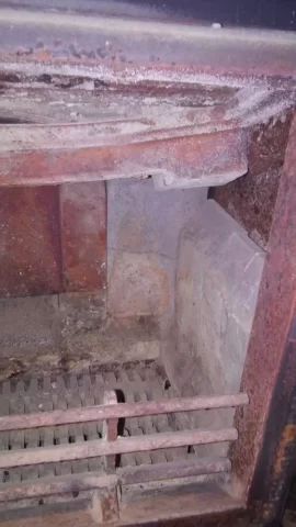

Inside. Pics following...
So your saying if the ID PLATE is missing, I HAVE TO USE guidelines for 36" clearances...so 3 feet on each side?

Looking like this is a coal stove. If no ID, try posting the picture on the coal forum

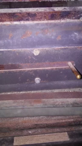

Yes it is obviously a coal stove but I have never seen it before. And I work on lots of harman coal stoves I like the look of it though. Have you called harman and sent them pics? It also looks like the piece on the top in your last pic may be warped can you post a better pic of it?

The piece you said is warped seems quite solid, but I don't know anything bout these lol

It looks in decent condition from what is showing. The stove will burn wood, but very inefficiently with a lot of heat lost up the chimney. The air supply is wrong for wood and there is no baffle or secondary combustion system. Let us know what you find out from Harman. This is an interesting stove.
If it's a coal stove, can I use it as a wood stove?
You can but it will burn through wood like crazy. That does look like a pretty badly warped piece on the top. It looks like it may be part of the baffle but hard to tell from the pics.
Yes, it does look warped. Maybe a basic airwash deflector for that large window?
You know they did make a convertable wood / coal stove that looked similar to that we used to work on one but I am not sure if that is it. If it is you may be able to get the parts to convert it to a wood stove which was epa approved.
No it looks like it is back way to far in the firebox for that.

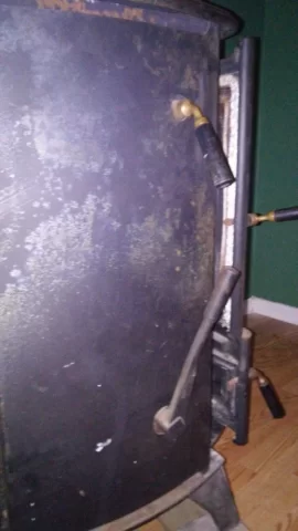

I thought these handle were to switch from coal to wood

Even with the handle on left side of stove? Seems to me it was to switch from wood to coal
What handle? What does it do?
Ok those handles. And I really think that is their convertible stove. But you need the parts to convert it. The bottom handle is for the shaker grates the top one looks like a bypass handle which probably wont work with that upper part warped the way it is. What does the upper handle do when you move it?

It opens up a metal vent. Opens and closes pretty easily. I can't get a good pic to describe it
ok so it is a bypass and atleast it works. When closed does it seal on whatever frame it rests on? Or is there a gap where it meets that piece that looks warped? I wish I remembered more about the stove we used to work on but it has been a few years and I just don't remember anymore.
