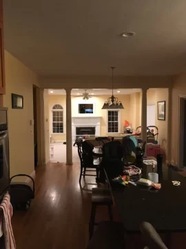

Not sure of sqft. Whole house is 3650 so maybe 1800 downstairs. Attached is the room I’m trying to heat. Living at 67 in 17 degree temps. -26 is really cold. Coldest I’ve seen in mass is -12.
Tell me if it looks realistic the heat this area with the stove

You shouldn't have any problem. Is there an upstairs that the heat can follow the stairway, so the heat doesn't stay down there? Run the stove on high. In the middle of where the heat comes out, put your fingers there. If you can't hold em there for a couple seconds, it is producing the heat it should be. Just did it with mine. kap
