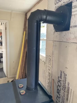

set up: From the top of my stove to the center of the horizontal pipe going through the wall is 40 inches. The horizontal pipe is a dura-Vent insulated wall pass-through this slides into my vertical liner. The horizontal length is 24 inches. All of this now attaches into my Dura-Vent Dura liner double walled stainless steel rigid insulated liner. It has a clean out of 8 inches to maybe a foot and then 11 1/2 feet to the top of the chimney. From the top of the stove to the top of the chimney is 14.83 feet, with two 90 degree turns.

Does your horizontal pipe length have any rise as it heads towards the chimney?
Changing the first 90 out for 2X45's may be of some help. 90's suck. Adding pipe as you mentioned should be worth a try.

Sorry for the mess the stove room is getting a facelift.
  • [Hearth.com] Help with soot/creosote

Oh, sorry, chimney cap does have screen which is maybe 1/2”. Horizontal pipe is level (Old Ashley actually went a bit downhill to get through the thimble, but it went through the back of the stove so it only had one 90 bend).
I researched the 45 stove pipes When I installed it a year ago but was actually talked out of it, can’t remember who, somebody in the business..
Is the bottom of your liner sealed up? And who ever talked you out of 45s didn't know what they were talking about
