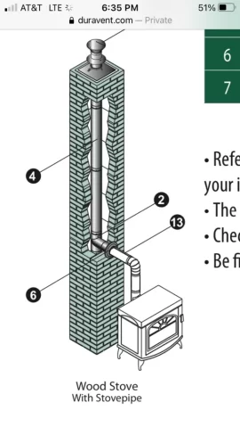

Sorry bholler not tracking. If your asking me if I have an actual clean out to get to liner, I don’t have one. Here’s my set up except my stove pipe comes off the top of my stove.
My masonry chimney actually starts in basement and runs through to main level, and on up. Chimney is on outside of house. There is a masonry thimble in basement that I have covered ( don’t know if any of that makes a difference).
Ok and you have a tee cap on the bottom of the tee?

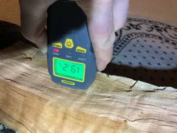

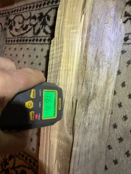

Stoveliker, I did have some big ugly chunks that have been inside for 48 hrs or so I was able to get split . Poplar and Cherry. A little higher than what I would have thought but still below 20.
