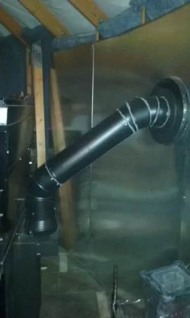

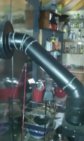

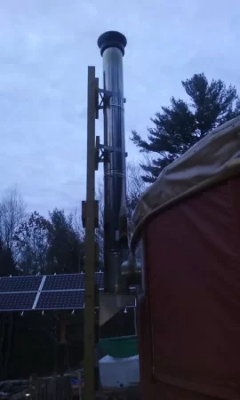

Can you post a picture of the interior hookup and an exterior shot of the chimney?
[Hearth.com] Help with sudden draft issues!! [Hearth.com] Help with sudden draft issues!! [Hearth.com] Help with sudden draft issues!!
Looks good on the inside. Outside chimney could use another 2-3 ft. added to improve draft. Also make sure the clean out cap on the bottom of the tee is snug and not leaking air. In the meantime use very dry kindling + wood and give the stove and chimney a longer time to warm up before changing the air control slider. Cooler weather should help improve draft.
