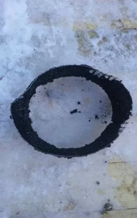

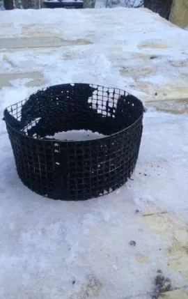

My husband got frustrated enough that he climbed the support post for the pipe and took the cap off. He then removed the screen which looks to be the best bet for the root problem. Apparently our chimney brush wasn't able to even touch the screen to clean it. Removing the screen fixed the entire problem Immediately! Thank you guys so much for the advice and help!

I should add those spots that are removed in chunks us from where he threw the damn thing to the ground in victory so it was solid black with tiny pinholes o.0
yeah that would cause a problem
