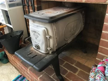

Hello all,
About 8 years ago, I got a US Stove 2421 wood stove and put it into my fireplace. See picture below. Well, I was enjoying it and everything was fine, until I got married. Actually it was a couple of years after I got married when the wife finally fessed up that she didn't like it because it "makes the house smell funny".
Part of this may be because of the way I run it, I try to get the fire going real good, then close the damper thingy as much as I can to get it to be more efficient. I hate the idea of all that heat just going up the flue, when it still seems cold in the house. (House is 1400sq foot A-frame). I think part of the problem is that the house is a bit "loose", and I get drafts coming in from places.
Also, sometimes I use a box fan to blow are around the back of the wood stove so the heat can come out into the room.
Anyways, wife complained, so we haven't used it in 2 years. It's getting cold again and with only electric heat, my wallet wants me to run the wood stove again... So I'm kind of at a loss as to what to do because I want to keep my wife happy, but I don't want to run the electric heat.
I'm considering the following ideas and/or combinations of them:
  1. get a bunch of stove cement and try to seal up my stove. (Do I need to take it apart for this?) (Will it make a significant difference? I don't generally see "smoke" leaking out from seems, but I don't know where the smell comes from)
  2. Add firebrick inside the stove. (Currently it's just an iron box with a bed of ash in it)
  3. Add firebrick outside the stove.
  4. Move the stove further into the room and add some kind of exhaust heat extractor to raise efficiency.
  5. Replace the whole thing with a new stove or wood stove insert. (Do wood burning inserts cause smells like mine does, or are they better? Would I see similar efficiency with an insert, or does a lot more heat end up going up the chimney?)
  6. Add some kind of fresh air intake. (Possibly with a fan) (Maybe snake it down the chimney parallel to the 6 inch exhaust pipe to help the air temperature coming in if I can somehow keep fresh separate from exhaust so I don't get a smell.
The main effort is to eliminate "the smell", and secondarily to get the whole thing running as efficiently as possible.
Your thoughts and impressions are greatly appreciated.
Brian

When does it actually smell? At all times, or just when the door is open? Are you burning good dried wood? How are the stove temps when you "close up" the damper?
How is the condition of the gaskets for the door(s)? Do they pass the "dollar bill test"?
I'm no expert, but I don't think its advisable that the stove should be installed that close to combustibles (carpet) due to risk of sparks/embers. It is far better than a stove with a wide door and loaded east-west, but do be careful.
Honestly having used this same stove 2 different times here are my suggestions...... Take them for whats its worth.
First cut up a bunch of wood and split it, depending on the type of wood it will be ready to burn in 1.5 - 3 years.
Second take that stove to your local dump and pitch it. I have never seen one of these types of stoves running and not get some smoke smell in the house.
Third buy a new stove. There are a many good stoves that are cheap now a days.
Forth if you do not have a liner you will need to buy one and install it.
Then you will be able to run your stove and not have the wife complain.

Seems to be a pretty rough install. I worry about the carpet catching on fire from an ember falling out and not noticing.
Also I'm curious about the liner situation? Did you just attach a bunch of single wall pipe to the top of the stove? Did you use and insulated flexible liner? Zooming in looking at where the pipe attaches to the stove it looks rusted real bad, maybe dirt, can't tell.
#1 is the chimney.
What diameter and height is the flue? Interior or exterior? Masonry?
#2 you need 18 inches of floor protection in front of the door.
All seams should be sealed with something like Rutland Stove and Gasket cement, (you don't have to take it apart to seal) but when you fix the problem with the chimney, it will only leak air INTO the stove, not out. Sealer is needed to slow it down from leaking air in.
Careful with how much you close the flue damper. That is a chimney control to slow draft. Depending on your chimney, you may not be able to do that. That is why I ask for chimney specs first.
If this stove is as old as it looks you might also post in the classic stove section.

usually when a stove has turned "white" like that it has been rode hard. only thing i would do with that stove is replace it.
I had that same exact model stove, the first stove I ever had, back in Georgia in 1971. I thought it was great at the time, because it was the only stove I had ever used.
Since then, I have had six more stoves and now I realize what a piece of junk that stove was. Get rid of it you won't believe how much better life is with a good new wood stove.

Be thankful it didn't burn your house down and properly instal a new stove or insert.
