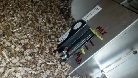

    The feed gate is the common problem with the mis fires. The amount of fuel being delivered, can be different with every pellet and every user (with Quad feed gate). Where with the Omega, your feed is only dictated by the feed setting. Quads always start on High. But my gate wide open may feed a cup of pellets, where Joe Shmoe will only feed about 1/4 cup of pellets because of gate setting and pellet length.
    Im not saying it doesn't happen to folks. But for the most part, it could be avoided. I replaced my ignitor and it happened again. Only to find that my gate was closed farther than normal (I have "Marks" on the slide). Every year I have to touch them up. But anything below that Min line and starts are not gonna happen.
    Based on SLLS's results (and mine without Low feed gate). I would say its almost always due to the user not having enough fuel delivered to the pot. And the manual makes no mention of this occurring. Only time the manual makes mention of the reset button is when starting your 1st fire or when stove runs out of fuel on pages 24 and 25 of the Classic Bay manual.
    Not pointing fingers or pickin on anyone. But I have never babysat the Quad. Does what its supposed to do. All day and night. While asleep and while away at work. Pics of "Marks" in the hopper (used to set this based on outside temp and let go 24/7).
