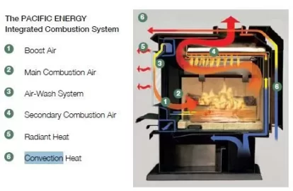

BeGreen can you tell me how the T-6 is convection my understanding is that it is cast iron over steel. I called Pacific Energy today and they claim it is a radiant stove I think they said that because I said we wanted a radiant stove. I would think cast iron would make it radiant is what I am getting at. I think you are right I believe do to how drafty it gets in my house radiant works better for us.

That's just silly. PE stoves are convective, period. You don't completely surround the steel stove with a jacket and get strong radiant heat. If it was so radiant, how do they have such close clearances? They are radiant from the front of the stove only.
Of course, you could focus on eliminating the draftiness. That would be an excellent investment and then a convective stove would work out fine.
  • [Hearth.com] Here we go again !
I am planning on getting the house insulated this summer if possible BG I can't wait ! We just have to find a reasonable contractor to have the walls blown in. It looks like the hearthstone will be it then although I am still trying to find that jotul f600 or f500 to look at.
