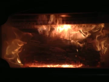

oh it burns, just not nearly well as i had hoped. i would say it burns like sweet gum. its the ashyness and the charcoal it causes that i really cant stand.

dang just wondering if there's a difference between pignut and shagbark cause as I read this I'm sitting here getting toasty next to my "January wood" which is shagbark. I prefer the way it burns over ash but not the way it splits.
  • [Hearth.com] hickory- thumbs down...

couple of other things. again... im sure its hickory. im a biologist by trade, i know my trees darn well. its certainly not poplar. if it was, i wouldnt have sweat so much cutting and splitting it. i am burning 1 YO red oak now- it burns 100% better than that hickory.
