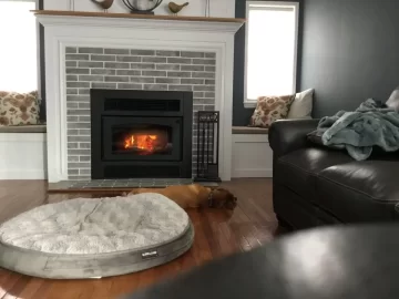

I have had the kozy for a year this past January. I like it no complaints.
  • [Hearth.com] High efficiency wood burning fireplace
