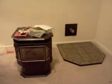

After much delay today, at around 3pm I took a deep beath and drove the saw blade into the drywall. Removed the square scrap of drywall and trimmed away the insulation. Went outside, up onto the ladder and cut out another square. This time the scrap consisted of presswood and vinyl siding. There's a 6" square hole on the side of my home, I've reached the point of no return. The thimble assembly went in and connected properly (after a tiny bit of trimming to the drywall). After the thimble were secured, I ran a 2' section of went through the thimble and attached it to the stove exhaust. Needed a little bit of upward tension to get the pipe to engage the appliance connector, so a little grinding with the Dremel will resolve this small issue. It was now dark out and time to feed the kids. To be continued tomorrow.

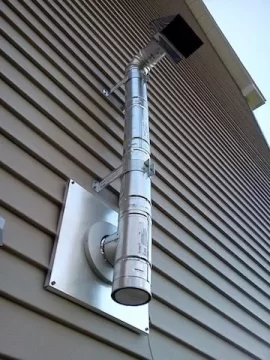

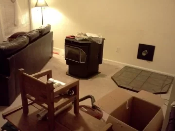

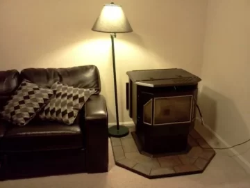

Finally completed the install yesterday. Code officer will be out in a couple of days to inspect it. Got 3 tons of Geneva pellets coming off the delivery truck in the next half hour or so. Can't wait to fire it up in the house. Its been unseasonably warm here, but its suppose to get cold again at night towards the end of the week.
Here are a couple of pics. Furniture stuff are there temporarily.

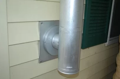

Can water get behind the thimble?
[Hearth.com] Hmm, can't get backyard any warmer
You may want to cut the vinyl out and put J-channel around it like you see below. Makes for a cleaner job and won't leak.
(broken image removed)
Otherwise looks great. Enjoy! I love my Englander EP!
Looks great!

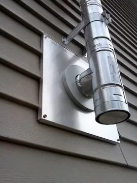

I used a neat trick I learned from the place I bought my stove. I'm sure J-channel is the best way but as a quick 'n' dirty way to seal it he suggested cutting part way through the high points of the siding, and letting the thimble rest in the saw kerf to help seal.
In your picture that would be 3 vertical cuts at each high point of the 3 siding slats. It is vinyl, right? I used a dremel with a cut off blade to cut down to where each slat touches the siding behind it. Don't cut all the way through the vinyl - leave it there with the cuts and then drop the thimble into the cuts.
It will seal pretty well. Then I caulked all around. I can post pics tonight if you want.

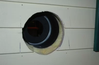

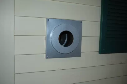

Good call guys. J channel looks great Graham. Don would really like to see some pics of your description to get an accurate visual.
Here you go...
After taking the pictures I used some GE clear silicon caulk around the entire edge of the thimble and some RTV around the vent pipe.

DonD, thank you so much for the pics, that's exactly what I'm going to do (for the OAK too).

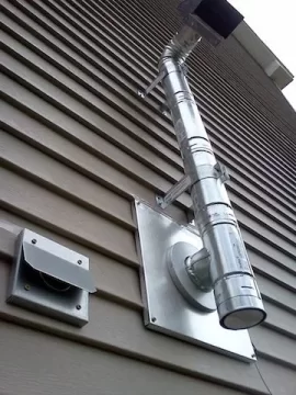

Got home from work this morning and decided to modified my thimble seating like DonD. Looked like there'll be rain here for the next few days, so I was motivated to sacrifice a little bit of sleep. Happy with the result, but I'll have to wait until the weekend to caulk it up.

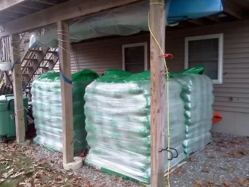

Here's a shot of my first pellet delivery also.

Hope your not considering leaving those outside.
They'll be junk in no time. :lol:
Right, Jay?

Looks great! I'd have gone even deeper with the cuts so the thimble was flush but that should work with some caulk.
I store my pellets in a covered porch not too different than you - maybe a couple of feet further under the roof (check the link in my sig for pics). I'd be very careful with wind blown rain and snow. I removed the clear wrap from my pallets but definitely am leaving the manufacturers cover in place. I'm considering a tarp too. So far I either pull up the cover and pull out a few bags (Barefoot) or climb up and pull bags out of a slit I made in the back of the top cover, farthest away from the weather (Okies since the pallets are too close to lift the cover - lesson learned for next year).
How's the heat so far? I know it's been kind of warm the last few days but we should get some pellet weather soon.

Agreed. I'm going to deepen the cuts and get it in tighter as well as caulk and seal all the seams on the vent this weekend, weather permitting.
Debating whether or not to build a temp frame around the pellets and surround it with corrugated pvc sheets as a temp fix for this year. Planning to put up a decent size shed next year.

I have mine dropped off in my driveway and that's where they stay. No problems with weather. I carefully open the manufacturer's wrap and close it up after I get the bags I need. I also cover them with a waterproof blue tarp and place a pallet on top to keep it from blowing away. I had about 15 bags left over from last winter and they were out in the driveway all summer and they were still good when I opened it back up.

I was joking.

OK. I just see so many posts on here about having to keep them in a warm, dry, comfy place. :)

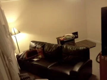

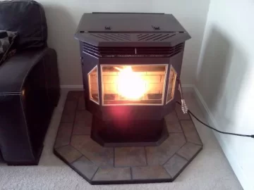

Code inspector was just here about 30 minutes ago, and gave us full approval. Soon as he left, we lit her up for the first time indoors. Don't smell any smoke anything and fire is going strong. Been a bit concern about the fan/auger noise factor, but it doesn't seem too annoying, so I think we'll just adapt to it and not even notice it once the stove runs 24/7 during the really cold months. Ahh, this room is getting really nice and toasty.
