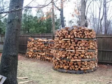

Hope this works this time. I'm axious to see if one seasons faster than the other. I still have to cover the top of the stack.

shizzam!!
that rocks man, i'd be affraid to stand near it..looks high..is it sturdy?
but damn man, nice job.
What is the diameter on that puppy?
Very sturdy this time. The stacking of the splits on the inside is what I think can cause problems. The ends need to contact each other. On the first attempt I was wedging the pieces in. The weight of the next level would force the wedge down and expand the whole thing. I thought the weight of the spoke splits would be enough to hold the inside pieces in but it wasn't. Even if it was to fall, it doesn't topple as you would think . It kind of crumbles. I think the stacks are actually more apt to be dangerous. The diameter is 7 feet.
that is awesome workmanship. How much wood would you estimate?
I really don't know. I read somewhere that at 7ft wide and 7ft high comes out to around 2 1/2 cords. With the rate my insert burns I'll need three of them for a season.
Very nice pile of wood you have there archer...you must have the patience of a saint.
Actually not all that much for patience but the thought of dealing with the wife after covering half the yard if I stacked it in rows was enough for me to get it done. When I finally get a grip on this insert and then heat the house for a season with free wood, well that should help the situation. I have been struggling so far but after reading more and more I'm convinced I can't make a complete judgment of my insert without truly dry wood Then there's the guys who say that the HH won't season any faster than conventional rows or that red oak needs 2 yrs to season. I sure hope not. The thought of dealing with the wood man again...... Makes my stomach turn.
Hey nothing cures wood better than being out in the weather like you have it there. I have never burned oak so I'm no expert but feel fresh wood spit and stacked like that now will be ready to burn in Oct...but like I said I've never done Oak...
...and yes, absolutely you'll be much happier with your stove burning seasoned wood. You can take that to the bank.

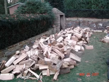

i got wood that was "seasoned" in the last week of nov
now most of it has cracks and so forth in the end of it.. while it is not seasoned it is oak and was covered most of this winter..completely covered
it burns much better than before and i can not wait till next year (this coming winter) because i know it will be much better...point is your wood will burn .. if we/you have a hot summer you'll really be all set
