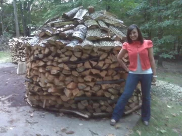

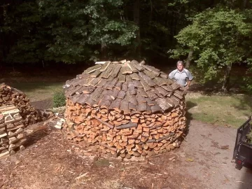

That big one I built is a 10 foot diameter one. I have build a 4 pallet one but it is not nearly as impressive and does not hold nearly the same amount of wood.

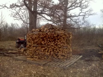

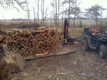

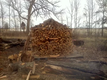

Mine is 10 ft diameter but looks smaller than yours. Could it be that mine is taller that makes them look so different.... or is it your roof kicks my HH roofs ass! lol! I agree that the roof is cosmetic and far from waterproof.
Was going to work on it more today but wind is 25 mph. Paperwork instead...ugh!

We must live pretty close, wind is kicking up here too. Mine was built on a slope and was much taller in the back (where I was standing) and also when my daughter was in the picture was several months later and shrinkage was happening. It is amazing how much they will shrink over time. One thing I did with my first one was split some pieces that had mostly bark and used that in a shingle effect, and that gave it a really nice look. But again, it is cosmetic, but people really like the look. Mine was eight to nine feet tall in the middle. I found I could step up on the sides and use it like a ladder to get up to reach the middle. After it shrunk it might have been 7 feet tall.
My originial one is up in smoke, and I sold some to some hearth members and gave some away, I needed the driveway space. Next big one will be in new spot, my 4 pallet one just not impressive. I saw you went 6 pallets which would make a 10 footer. There is a lot of wood in a 10 footer, but it will break your heart to tear it apart. One thing I found was you can take a piece of the pie and rebuild it to keep it alive awhile longer.
Pittsburgh is 3 or 4 hours drive I believe. Mine was also built on a slope. Taller in front than back. I didn't even bother to level the pallets. Ours would be identical dimensions. It will be interesting to watch it skrink down. On building the roof, I threw the barked pieces on top and then climbed up and stacked. Next time I will be sure to sort out good roof parts as I go along.

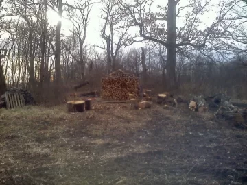

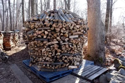

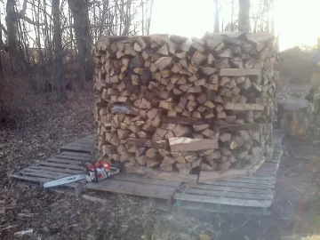

Want to highlight the "if built properly". I built my second HH a couple weeks ago (Super Bowl Sunday). If you notice in the picture I got sloppy in parts of the upper half and had a couple areas that the sides bulged out. Well Thursday afternoon I hear this crashing sound and look out and yep, my HH had a blow out. Havent fixed it yet cause we got a little snow Friday night and I didnt want to handle wet wood - I'll wait until it dries out. But, word of caution to those building a HH - keep those sides straight as well as tilting in.

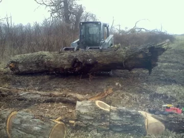

Normande, told ya beats agweb so much more in the form of content and user interface. White Oak? The bark on some of the younger branches that are 4-8 inch diameter flakes off like big paint chips. I need to create a new thread for that tree. The log is as long and straight as I have seen in my short years. I'll go with white oak because I know its not red oak or burr oak. There was parts with some black ants and wasps that I did not see in the red oak.

GotWood, sorry that yours took a tumble. I built mine during a windy week and so far so good. Hope you get it back together. Dig the plastic pallets

The only other trees I'v seen in eastern ohio/wPA with bark like that where cottonwoods and even more rare at that size Iron woods/ if you cut the main log and it smells like nuts it's and Iron wood, get it cut and split FAST, as if it dries out you'll ruin more chains than you can dream of. Oh and Calcutta is more SE Ohio, way south of Youngstown, AH the Old turf

Got Wood, you got that right, that is why I said if you build them right. I have heard of several people having blowouts. I am always careful to keep the wood slanting inwards, that way I do not think they can ever blow out, in fact they are so strong you can climb up and down the sides. Hope you get it repaired OK.

Nice weather today so I fixed er up. The problem wasnt the angle in - I had that - I got sloppy on ballooning out on the sides.

I mentioned this a while back... I use poultry netting wrapped around my HH's. Some are leaning, but no collapses yet. It might be cheating, but it works for me!

Chickenwire is a great idea for a problem HH. So far, so good here. Had 35 mph gusts. Glad you got yours back together gotwood

normande, I hope it is not ironwood. No way will I get that monster cut up this year. Tree cutter thought it was some type of oak. Hope white oak!
I'm bettings it's white oak I've only ever seen one iron wood that big in the 30 years I can remember and that tree was about 18" at the top of the main log, a buddy with a big husky made five cuts and had a dull chain. He cut them 3' lengths for his old taylorway and it took both of use to pick up the pieces, I'm 5 10, 205 and he's 6'3" 250, on the bright side those 5 pieces burned for 6 days altogether
