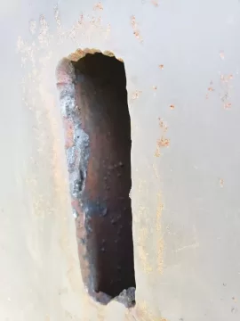

Success! Quite a white knuckler driving this gal through the mountains, but we both got home in one piece. This is an older KQ (1998), so it doesn’t have the thermostat. It also has a hole/slot someone cut in the back between the oven and the firebox. The seller never had a chance to use it and says is came that way. Based on his research, he found that the stove came with a vent hole in that location. So, it looks like someone just expanded it… for reasons unknown. Wasn’t a show stopper for me, as I weld and that’s a quick patch job. But, before I do that, I’m wondering if the enlarged hold might be a good thing? More draft? IDK.
What do you think?
All-in-all, I’m pretty satisfied with over-all condition. It was lightly used. Just needs some TLC and cleaning.
