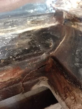

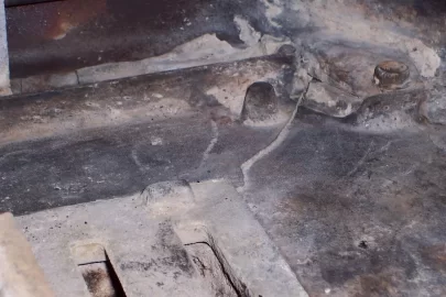

The 2008 F500 did not have a cat. It's a tube stove. It's a good heater, just be sure the left side has at least 16" clearance or better for sideloading. One thing to be careful about on a used one is cracks, especially on the base surrounding the grate. This usually is evidence of a leaky ash pan door gasket or someone continually opening the ash pan door for startup air. The base needs to be replaced in this case which is costly. This is what the cracks look like:
