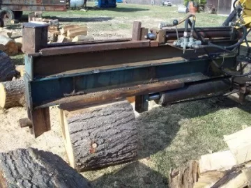

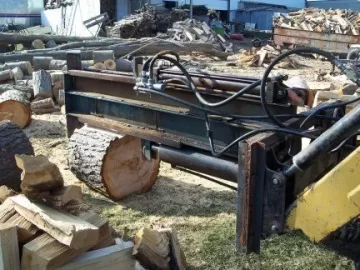

Can you guys post some pics of home made splitters. I would love to see some of the innovative ideas that haved served users well.
Thanks
Here's mine. The bottem cyl is from a truck dump box. 6inx32in and the top cyl is a 3 i/2 in x 30in. I'm running it on the low flow side of the skid steer but I'm going to run it off the high flow side soon so I can get faster cycle times. High flow side is 30GPM at 3000psi. I haven't found anything it won't split and I just let the skid steer move those BIG ones around to where I can lower the boom on them. I also have a 35ton Husky that I use most of the time but when I get those REALLY BIG ones out comes the Tank.
It was fun to build and because I used mostly scrap, used and salvage I've got less than $200 in it and most of that is hoses and QD fittings.
leaddog
