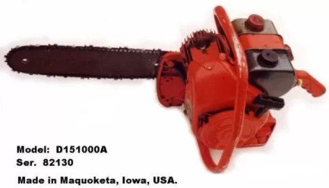

I have an old dude that will shred your hearing. It is called a "Bobcat" 4.6hp. I think it has a clinton engine for power. Looks like the attached pic, but has additional labels on it. Not to mention that while at idle on the ground, it jumps around like a little kid. Heavy sucker too.

That is the first saw I got from my dad.LOUD very loud. when you use that saw all day you know it . Do not miss it much.
