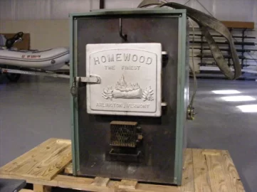

So here is what I suggest - take a picture of whatever tags/plates/placards you can find on your wood burner and post them here. That will help the folks on this site tremendously in figuring out what you have. And if you have an specific questions about the unit ask away. There a loads of people on this site running wood fired furnaces. I bet we can get you started in the right direction with a minimum of pain....and welcome aboard, for the record.
This is a picture of the "Homewood", made in Arlington, Vermont
does it look new ?? Apparently manufactured in the 70's...

Hello,
Regarding the Homewood Wood Furnace, Arlington Vermont, American Made.
Chris was nice to post a picture on line. I purchased the same mode in the late 70's and it has lasted and worked well. They clearly where made very well at the time with care and pride someone with some skill knowledge and integrity. The materials used and durability where excellant. Features that make it easy for the wood cutter, and stove user at the time, and yet well though out and built. Possibly the wood burning interest waned with then falling oil prices, new sales declined or the company moved on to other endeavors. They clearly contributed to wood burners and reduction in oil usage at the time.
That said nearly forty years have brought catalytic converters, ceramic chambers, boiler mate add ons, all significant improvements. Those earlier pioneers hopefully contributed to the success and advancement of these newer heat units.
Not all are ready to make upgrade to these very good units right away, that you guys have.
With that said, If someone has information about hot water add on products or experience with catalytic converters it would be most interesting to each of us who wrote in.
Thanks
Bill

Old thread, hope you read the previous comments...
Can't really say that I'd recommend ANY stove or boiler that is as old as these units appear to be, and especially given that the company appears to be out of business, and so on...
First thing I'd do is check w/ your local code enforcers, (and insurance companies) and find out what THEY require in the way of labeling on the unit (Most will require a UL acceptance tag on the unit, as a very minimum - no tag, the unit CAN'T legally be installed in many places... Many will also want to at least see a manual giving all the requirements for clearances, chimney requirements, and so forth for any other connections. Before I'd even spend time looking, I'd make sure that you will be ALLOWED to install the unit. (This can even be a problem for new equipment BTW, especially the "euroboilers" - even though the EU specs are tougher than UL, many places won't accept an EU certification, unless the company has also gotten a UL listing to go with it....)
If you can get by the inspectors, then I'd look for overall condition - be wary of major rust, look for any evidence of overfiring (i.e. discolored metal, distortion, etc...) If you go in the Hearth Wiki, there are some good articles on evaluating a used stove, most everything in them applies to a boiler or furnace just as well, so I won't try repeating the same things here.
