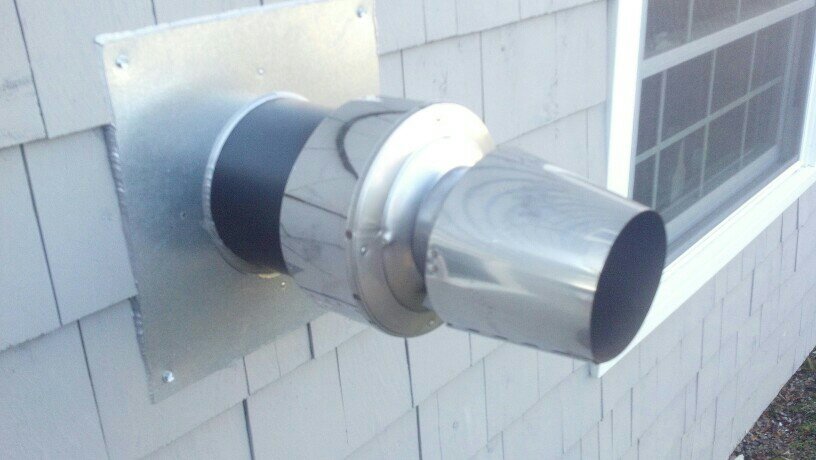

Has anyone had better luck with one cap over the other, The Simpson Square Vent Cap 33085 looks like a dryer vent, tucks against the house nice , but wonder if it too close an causes soot, Selkirk has a few some look like just a pipe with screen? another has a cone over the pipe, another one looks like the flying nuns hat ? Can't find much info on wether one is better than the other, anyone ?

Here's mine.
No, I run it just like that.
Not really what I'd call a mesh.

We have 3 stoves here, and all of them have different direct vent caps.
The Quad has a gizmo that looks like a dryer vent, but the pipe is off the ground quite a ways and sticks out from the house about 2 feet.
The big Whit has one of the screened 45 angled units and the little whit has a regular 45 elbow and is angled away from the wind and the stairwell the pipe is near.
Lots of choices.
Make it so its not a trip or other hazard, and will not soot up the siding.
I look at safety first, then comes convenience that is moderated by whats workable and the last item is aesthetics.
