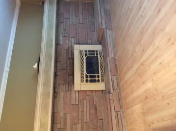

Said location. 21" from wall to edge of hearth. 44" mantel to hearth.

That is a low lintel, you won't have many stoves to choose from. The Keystone is probably best for your area as you can regulate the heat output better since it is a catalytic stove. Plus, it will give you pretty long burn times although I suspect that for 10 hours you will need to run it on low most of the time. Two other options of non-cat stoves that would fit are the Hearthstone Castleton and the Regency H2100 Hearth Heater; the latter may be a bit small for 10 hr burn times, though.

The hearth is only 21" deep from the front of the brick. That might severely limit my options. See the above pic and measurements. The masonry fireplace is on a wall that has our garage attached.

That makes the Castleton too tight of a fit. The Homestead Hearthmount may work but be aware of its high r-value for hearth protection. Is the mantel combustible? You may need a shield for that when you get a hearth-mounted stove.

It looks like the hearth could be extended at floor level with basic ember protection to meet the hearth requirements.
