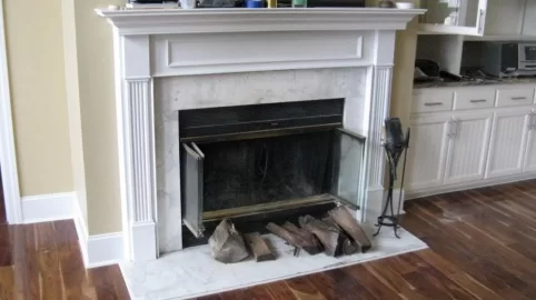

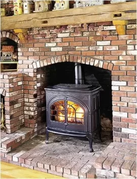

Could we build a chimney with a fireplace that would accept a wood stove, or are we just wasting our money.Essentially a wood stove in a fireplace. Note the attached pictures.

Yes, you could have a properly designed fireplace built that will be large enough to accommodate a freestanding stove and then at a later date remove the stove and liner if so desired. That is a very expensive approach, but can be done. Another option to consider would be putting in a high quality zeroclearance EPA fireplace. That way you get the big fireplace beauty with some good heating. Some units can even be ducted to help with heat distribution.

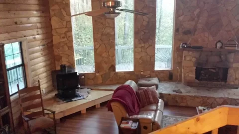

this is where I am heading in western NC mountains where it gets a lot colder. Keeping the gas fireplace for when it is just a little chilly and when you want that fireplace look. Those new gas logs do incredible in both their look of a real fire as well as the heat they can put off. But I always wanted a woodstove especially when it gets real cold so I do not have to use other heat sources. Planning to go up through the wall and then up with triple wall pipe. Best of both worlds, fire place for ambiance and light heat and wood stove with bay window for some serious heat and real wood burning. Hope you call can see the link to my FB photo. I just got to get back up there and finish the new hearth to match the old and run the pipe.

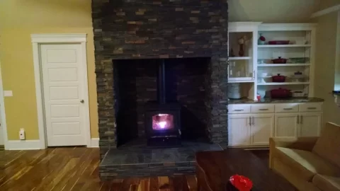

Agree w/ BG about the expense. It's a nice look but all that masonry will cost much more vs. running some stovepipe. As you are in the planning stages, see if you can have the chimney/stovepipe on the interior as opposed to an exterior install. Much better performance.
Here's what we did:
From:
[Hearth.com] House planning: Woodstove and Fireplace
To:
Warning: By far the cheapest part of the install was the woodstove at about $750 or so. 30-NC on sale at HD.

Also you can't talk about efficiency in one paragraph and going through the wall with your chimney in the next. Introducing two 90's into a chimney is not what I would plan to do unless there where no other options. Straight up and out for efficiency and serviceability.
When your house is already built and built by someone else, you have cathedral ceilings with very expensive wood with with a small attic full of insulation with 0 access to that space, going up through the ceiling is not always an option. There is literally no way to get into the attic, our best guess is it might be 2 to 4 feet between the ceiling and roof, and have little clue how it was built up there. Sometimes you just do what you have to do.
