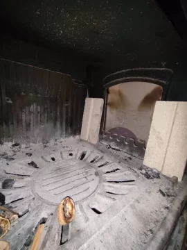

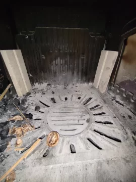

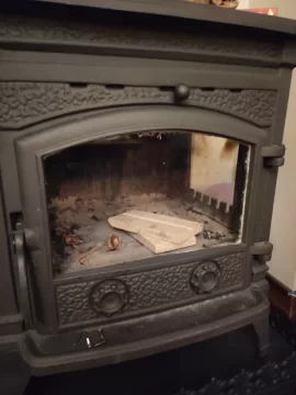

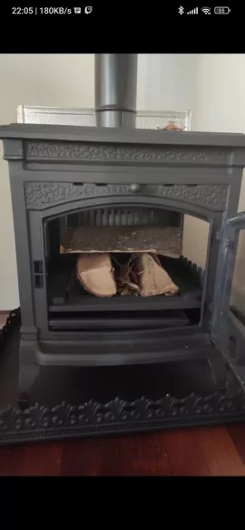

Hi, last year I got this wood stove. This is a cast iron model approximately 120 Kg (260 pounds).
It has 3 windows (unfortunately there wasn't much single windowed options here in Turkey). One on front 2 on sides. Actually it even had one in the back but prior to ordering I told them to replace it with cast iron as it was optional.

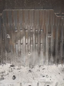

The back part which is removable, looks like a double walled structure. It has 10 holes in the firebox part but you can't see the anything. The holes don't just go out of the stove. On the exterior of wood stove, back side has 2 venting holes. Again you can't see the firebox from the outside. So my guess is it's double walled. I used a hair dried at full speed to test if it took air in, and yes it did.
There is also a secondary air intake on top of the glass.
The shape of the stove is rounded by sides. The back and front isn't same sized. So i realised the baffle (which looks cast iron around 3mm) isn't well insulated. Because it's a square while the stove isn't a square. And some smoke actually runs form the sides. I ordered 8mm gasket and i will insulate it soon.
Now my question is this stove has a taller firebox than models I have seen on the Web and YouTube. The baffle is really way above. And also there is a good distance between the top of the stove and the baffle (around 10cm~). Would it give secondary burning?
If I had the skills I would add a stainless steel tubing to the baffle and drill the back of the stove.
This model doesn't come with firebricks as its already very sense cast iron, i thought about adding firebricks to the side windows as they are not small. To increase overall firebox temperature to achieve secondary burning.
Or i could add fire bricks to the back side and try to drill the bricks so that the vent holes can deliver oxygen by negative pressure.
Does it make any sense to add fire bricks? I will add pics with measurements on them.

So it can burn coal. That’s a hint. I didn’t see any manual do you have one? Basically you need to get a fire going then turn down the primary (bottom air) once the fire is hot. Do you have control of the secondary (top) air separate from the primary?
Coal is different it really need bottom air.

That's a sweet looking coal burner! All coal stoves can burn wood. Difference being as noted they will take draft from under the grate never above. They will not have any control for secondary burn save for any permanent baffling as part of the stove itself. For wood though my guess is burn times would be limited. For coal I could see 12 hour constant burn time there.
Unfortunately no manual. There is the top air intake you can turn on or off above the front window part. On the back there is a small double walled part with 2 intake holes (3mm probably) and 10 intake in the firebox side. That's the only place where secondary burn could happen I guess.
The primary (bottom) and secondary (top) has different controls yes. I will redo the gaskets for side windows.
I guess we will see if it does do secondary burning this winter. Climate is very good right now house temp is around 23C and outside it's like 17C.
I put 4 pieces of 20x10x2 firebricks on corners to increase firebox operating temperature. I guess I will buy the side glass cast iron parts for the future. Because eventually there will be no parts left in production.. They said you need cast weld to install them. So i will keep my glasses.
I have seen people modding their cast iron stoves to add tubing with secondary intake.
Manufacturer say the top air intake is for air wash for front glass.

Not sure if it's been said above, but you could add brick to the bottom (floor) of the stove, to get the fire closer to the baffle. I'm not sure it's all going to work though.

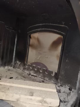

Many times we see stoves that the glass was broken and just replaced with a piece of flat steel that was about the same thickness as the glass and cut to the same dimensions. It would get installed using the same gasket material as the glass.
Take some pictures of the Inside. I would like to see how they designed it. And a picture of it burning. Video is even better.
generally speaking coal stoves are not good wood stoves. And wood stoves can’t burn coal so I am guessing there were some compromises.

Ok. I was asking about efficiency, because if it was good you would likely not benefit from adding tubes.
You mention pellets (6*30 mm)... I don't understand that, as there is no feeding mechanism. Of course you can buy pellets and burn them in a wiid stove, but that is rather cumbersome.
If the stove has a 9 kW rating it'll burn about 2 kg per hour (at THAT output rate!). So a 8-10 hr burn time should be possible. There are fudge factors here (efficiency, and assuming an optimal system, and maybe the 9 kW is on the low side of the output range, etc. etc. etc.).

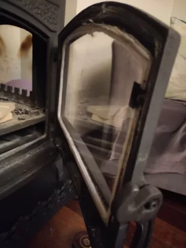

They have thick cast iron parts for glass. But installing requires some welding :/ I will still buy the parts for feature. will post a link below. I will post a video next month when i burn this stove with dry oak. I will try the secondary burning thing too and I will check the flue smoke output (how visible etc).

How about setting a piece of metal inside of the glass? It'll reflect the heat back into the stove,.

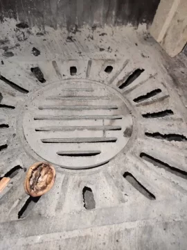

You can fill the coal grate with ash to eliminate air from coming up from the bottom. Then its down to keeping heat in the stove. Is there a baffle?

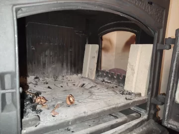

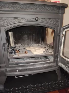

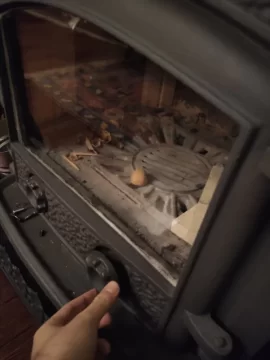

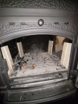

View attachment 300539 View attachment 300540 View attachment 300541 View attachment 300542 View attachment 300543 View attachment 300544 View attachment 300545 View attachment 300546 View attachment 300547 View attachment 300548 View attachment 300549 View attachment 300550 View attachment 300551 View attachment 300552 View attachment 300553
I like the idea of the bricks in the corners and if all they do is keep the wood off the side glass great. Fill it full of wood. When I reload I fill to almost touching the top. I light a top down fire.
Looking at the pictures it is not going to have secondary combustion like a stove with secondary burn tubes at the top. If it keep you warm I’d say it’s good enough. Changing an approved design to make it better I think is difficult.
I added the fire bricks to prevent cracks on the corners (no idea how likely that is tho) and to have more heat radiate when wood is all burnt. Also to increase the efficiency if that makes sense (I have no idea lol).

Should I load the stove fully to achieve a 10 hour burn time? It could over heat the stove lol
Yes, more splits per load until you are comfortable with a complete load. Load all splits straight in or what is referred to as north/south loading. See what kind of results you get at each level of loading. Unless your draft makes the burn uncontrollable you should not have to worry about overheating.
Almost seems to me that the 2 lower air control knobs may be for coal burning primarily as they introduce air under the load?
Believe I'd try a few different approaches to burning until I found a good repeatable method.
Maybe try supplying all primary air with the upper slide control only (2 lower front knobs closed). This would replicate wood burning stoves that I am used to. Appears as if there may be regulated or unregulated secondary air supply entering the back of the firebox through the series of small holes as well.
No idea what the hearth insulation requirements are for this model? I would surely think more ember protection in front would be appropriate.

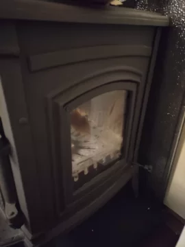

Yeah so little update.
I did insulate the baffle fully. I did insulate the grate and some edges inside the stove.
I used a 8 percent humidity 2 year old oak. It stated to burn very fast ;D
It burns very clear. I turned off main intakes. Just the airwash and back vent holes.
Yeah the stove has seen 270~ Cs. 550F~ and you can see the back vent hole burts probably some secondary burns.
