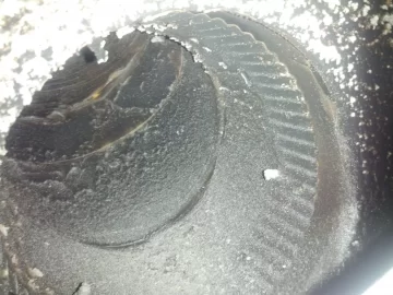

During some stove downtime today, I removed the baffles to get a peek up my liner. Here is the pic I took. Being a first year burner, I haven't a clue what the liner should look like after 3 months of burning.
The buildup is more than I expected but, it is only a thin layer of powdery material. It easily comes off on my finger when I touch it.
I plan on sweeping the liner this weekend but I wanted to get some thoughts about this amount of buildup after 3 months of burning. Normal or not?

I have a hard time telling from pictures but you'll get a better idea once you sweep and take a look at the size/makeup of the pile.

Not horrible.
I am assuming first year burner with less than optimum fire wood?
Not bad. Continue on your plan, and check it & sweep as you can.
We're getting hit with a cold spell, good idea to sweep it this weekend.
What does it look like at the cap?

The cap looks similar. Maybe a bit more flaking.
Bottom looks fine you can still see the ridges in the liner. The top will tell the story the bottom usually stays pretty clean with an EPA stove.

If that is all you have after 3 months , then with a bit drier wood you should have no problem , this winter . Just check and sweep when necessary and your good .
doesnt look bad at all to me. I wouldnt even bother cleaning that little bit.
Check the top of the stack for the real picture.
Thanks guys. I'll post a pic of the top a bit later. I don't figure it'll hurt to go ahead and sweep. At the very least, I'll gain a little experience.
Looks fine on the bottom. Nothing alarming
