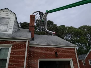

	![[Hearth.com] How do I work on the top of this chimney? [Hearth.com] How do I work on the top of this chimney?](https://www.hearth.com/talk/data/attachments/218/218392-b8e740a7eb81f96feaad7115afe64ae9.jpg?hash=IHViD1nO5v)
