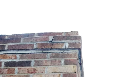

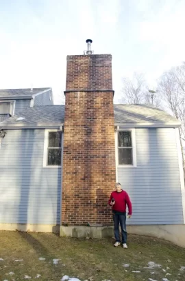

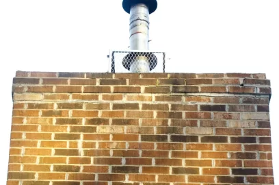

How do I work on the top of this chimney?
fire_man
Feb 6, 2009
2,793
North Eastern MA
The chimney is about 23 feet tall and naturally the part needing repair is not accessible by standing on the roof. The photos show the repair areas and I also might add a concrete overhanging crown if I can't repair the old one. The other sides of the chimney are in much better shape and need only minor repointing.
Is there some kind of ladder stabilizer that might work - the stabilizers I am familiar with are hard to use on a chimney because the support feet force the user to be quite a distance from areas needing repair, meaning I have to do lots of reaching.
I know the right answer is to set up scaffolding but it would take lots of stages and I'm on the gable end which gets complicated, time consuming and expensive.

Dont take long at all to setup scaffolding (My first choice). You may have to rent some. Doing that job off a ladder would be very challenging if not dangerous.
Absolutly scaffolding it looks to me like you need some relaid to not just pointing. Honestly if it was me i would be looking at extending the chimney up anyway so you dont have that extension sticking up like that.
And i can tell from the condition of the chimney yes you need a crown
Thanks Bholler.
I just checked scaffolding prices and they are not as bad as I thought. $194 for a week and they tell me its a freestanding structure which is easy to build, does not have to be tied into the house and will allow me to reach 23 feet. I was sure that height would require mounting.
