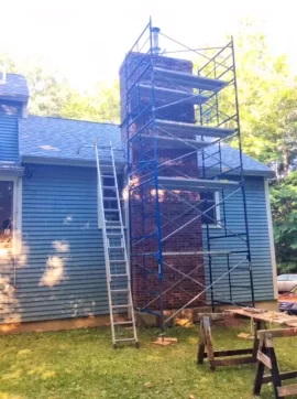

On youtube there's all types of riggings used to work on chimneys that keep one from putting weight on the chimney.I will never put my weight on a chimney.They can look strong but don't trust it.Invest in safe rigging.
![[Hearth.com] How do I work on the top of this chimney? [Hearth.com] How do I work on the top of this chimney?](https://www.hearth.com/talk/data/attachments/227/227613-f77064bbd94402a7992d5074b7d89d67.jpg?hash=WIhrRcvpBs)

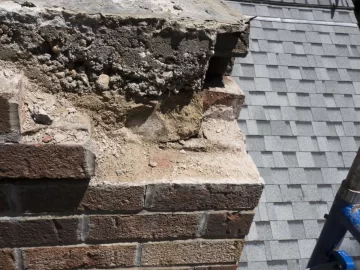

Because the brick structure the clay liners and the concrete crown all expand at different rates. Over time this can cause damage.Does anybody know why the need for a bond break is never mentioned when pouring a non-overhanging concrete crown (see previous post picture) ? Is it because non-overhanging crowns are not usually done with concrete and i have an unusual setup?
It shouldnt be done that way there is no way to do that correctly.I have a poured concrete crown but its inside the brick and not overhanging.
Its just feathered using concrete to the brick edge. How should you do a bond break on that?
Should I feather the concrete using mortar on top of the brick?
Most masons dont do proper crowns and that is why we spend all summer rebuilding the tops of chimneys many of them only 15 to 20 years old. Wash crowns simply are not very durable. And mortar that is to hard causes just as many if not more problems than soft mortar.A bricklayer I once knew would lay the top several courses in a mortar with a higher portland ratio and less sand and a feathered cap of the same strong mix. Something about the more sand the more water it would be prone to absorb. He had his own special "recipe" for it. He humped it in the center and sloped it to the brick's edge for runoff. He never poured an overhanging cap unless the house designer specifically called for one. He built probably thousands of chimneys in the most upscale developments over his career. A thick overhanging cap is quite rare in these parts actually.
Needed yes but there is no way to do it and keep the crown water tight. This is why wash crowns usually fail around the edge. And or crack from the corners of the clay liner.Is a bond break with the brick needed when the crown is done with a mortar wash?
Yes the thinnest part and allot of stress thereMakes sense. That's where my crown failed and mine was a "concrete wash".
