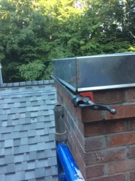

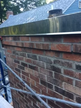

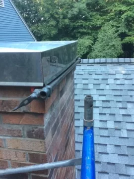

Well I finally got the Stainless cover mounted and thank goodness my measuremts were right on for the cover dimensions and flue cuttout.
It was really hard to get the cover to sit properly. It kept twisting so the corners were popping up and down because the sheet metal was acting like a giant unstable spring. I would almost get it right and then SNAP the sheet metal twisted with a loud bang.
I used some long pipe clamps for it to rest on and all finally went well.
You chimney sweep guys have my utmost respect, this work has not been easy - at least for me.:confused:

Will the pipe clamps require periodic tightening or do you somehow have them permanently fixed? :p
What secures the cap to the chimney? The fabricator did a nice job with the metal. Nice job!
The pipe clamps were a temporary solution. They were used as a foundation for the cover (ie cap) to rest on long enough for me to permanently install cement scews into the cap's skirt. The pipe clamps were used as a solid base so the cover would take on the same shape as though it were resting on say a cement floor in your garage - nice and flat so I could secure it with screws. Without the clamps it twisted and literally SPRANG into a contorted shape that was impossible to flatten even with two people working at opposite corners.
The cover still needs to be secured with Ten 1/4" cement screws around the side skirts. It's the top plate for my SS rigid liner and the liner's top clamp rests on it.
Rockford Chimney made the cap and did a fantastic job. I measured and it was exactly the dimensions I requested and was accurate to better than 1/8". That includes an offset hole for the flue pipe which I was most worried about.

I was just having fun with the pipe clamps. Just remember that every hole in the flashing is a potential leak to assist/create freeze-thaw damage.
EDIT: Since the liner clamp rests on this flashing/cap-and depending on the gage- I would think one fastener on each side would be sufficient.
I kinda figured the pipe clamp question was for fun but wasn't sure ;lol
The only hole in the cap is for the 6" liner to pass thru and that's covered by a storm collar. The cover has its own 1" tall collar that the storm collar rests on.
I propably could get by with 4 screws but Rockford suggested 3 on the long sides and 2 on the short sides. Its a 6' x 3' cover so pretty heavy and tends to want to sag on an uneven crown.
