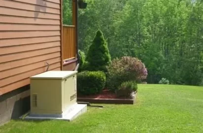

my setup was fairly expensive compared to a battery backup for just the boiler, but runs the whole house and boiler system. We have had two weather events here the past two years that have made it worth the effort.

Awesome set up Snowtraveler. Your set up is on my list of things to buy/do it just happens to be item no. 3317 I see the yellow feed line to the Generac is it Propane fired?
yes, propane. thank you.
