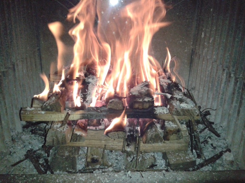

There are multiply factors that go into starting a fire that doesn't fissile out. And lights up quickly to a roaring fire. Any one not done will be an issue. Do this and it will lite ever time. Guaranteed!
Seasoned wood
Proper log cabin style stacking in the fire box. Spaced off the floor. This is key.
Fire starter between the 2 bottom closely spaced splits.
