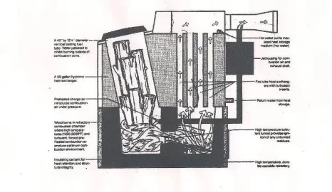

The Jetstream is a much older clean burning technology with a very large refractory component .It depends a lot on how long it has been between firings how it is lit . For firings that are only 24 hours apart put 3 lbs of kindling into the bottom of the burn chamber the paper on top of the kindling light the paper turn the draft inducer on leave the loading door ajar when the kindling has been reduced to coals ( about 5 minutes )add a full charge of wood close the loading door and the forced draft kicks in and its away .When firings get up to 14 days between firings in the summer month for DHW supply the lighting sequence becomes a little more prolonged . To allow the refractory to warm up gradually I may go through 3 or 4 batches of kindling before adding full charge of wood then still running on just the draft inducer until I can hear gasification taking place then shut the loading door and going to full forced combustion. Sounds tedious but I get a lot of satisfaction out of how many years that I have been able to get out of the refractory 30 + years and counting .When the boiler has sat 2 weeks or more it is possible to have the boiler to full gasification with in 5 minutes , but when I clean out the bottom of the burn chamber for the next fire there will be small bits of refractory in the ash . Your modern types make it sound so easy !;)
  • [Hearth.com] How Do You Start When Cold (no coals)?
