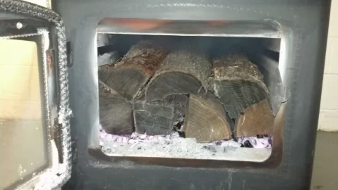

    For longer burns, I use larger pieces. But for tonight, its average/medium splits. I would normally do 8 (4 top/4 bottom). But, again,, not needed on weekends really. Longer burns, Larger splits. Shorter (hotter) burns, smaller/med splits. But try and pack them.
    Here is a pic. Pics would prob help give you a visualization. I need to scoop ash tomorrow. I let it the coals burn down quite a bit, as we got a good amount of Solar gain and temps today were mild.

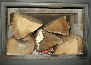

    Since putting in the baffle in the Grandma Bear I burn 2 splits east / west in the stove during the day. For overnight 5 splits will burn 10 to 12 hours.
  25. DexterDay
    DexterDay
    Guest 2.
    If thats a Grandma Bear, then those are some LARGE splits. About 8"? Or so?
