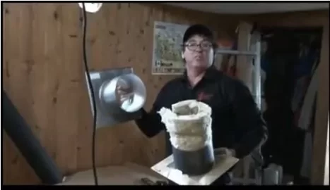

How many of you put nice fire rated insulation around your pellet stove wall thru like the guy in the video?
This Selkirk at Lowe's comes with some insulation on the inside. Selkirk is a Top name in Pellet Stove Venting and I assume they did test it.
If you listen to the video carefully, The Tech states that the Product is an "Insulated Wall thimble" meaning he did not do that himself. So it must be UL approved also.

IT IS DESIGNED TO BE AN AIR SPACE AROUND THE PIPE....DO NOT INSULATE!!!!! You can insulate around the outside of the cylinder.
Actually when you think of it, adding more air with an air space goes against everything they teach about smothering fires. Air is fuel for the fire! Adding fire rated insulation will help to smother the fire!
Just look at this video you may understand the properties of Rock Wool a little better!
As they say in the video, "Have you ever seen a rock burn?"
Believe me after seeing this I feel much safer having my pellet pipe surrounded by rock wool than an air space! Wow! ! !
(broken link removed to http://www.rockwool.co.uk/why+rockwool-c7-/fire+resistance/does+it+burn-c7-/does+it+burn-c7-+wooden+house)

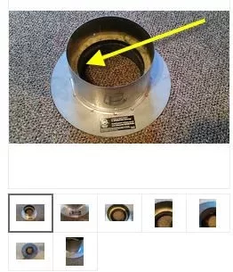

Lowe's now sells the new Selkirk wall thimble with insulation on the inside!
For Wood or pellet Burning -- "UL safety listing - YES" see specs below
This Selkirk wall thimble at Lowe's comes with some insulation on the inside!

If you watch the video you posted, between 2:10-2:40 he talks about it being an insulated thimble and just like the Lowes one its probably been designed to work with insulation. If the one you have came uninsulated I wouldn't just stuff insulation in it as it wasn't designed and tested to be insulated. I would just seal up the air leaks, probably the biggest culprit to heat loss and call it a day.
Why does this Selkirk wall thimble at Lowe's come with insulation? Insulation is inside!

Here is another Insulated Excel Thimble that can be used for Pellet burning
(broken link removed)
Insulated Wall Thimble for Gas, Pellet or Wood Stove ~ 4 3/4 to 5 inch
See insulation inside inner ring to seal pellet pipe. Nice Idea :-)

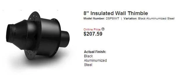

This insulated wall thimble is Tested to ULC Standard S-641 and UL103UL-103 Standard
http://www.menards.com/main/p-1936086.htm
However, The pellet stoves and accessories sold in home stores must be UL approved and safe or they cannot be sold! Selkirk is a TOP name in pellet stove venting! Maybe you should try it and get more familiar with it!
For the money, I think I would go with the Selkirk.
It looks like Selkirk uses Roxul rock wool insulation. It's temp rating is 2150 Def F and R=22 for 6" wall.

Looks like it maybe a good summer project for next year. According to this Menard's wall thimble ad, this insulated wall thimble is designed for all fuels!
Better Insulating Value = Superior Stove Performance
Also
This insulated DSP Double Wall Stove Pipe is listed and tested to ULC S641 and UL 103 standards.
8" Insulated Wall Thimble
  • Smokepipe Accessories
  • Tested to ULC Standard S-641 and UL103UL-103 Standard
  • All residential fuels, gas, liquid, solid. UL103; ULC S641
  • An attractive outer black painted surface made of durable aluminized steel to withstand temperatures up to 1200 degrees F of continuous operation
  • Better Insulating Value = Superior Stove Performance
  • 6" Clearance to Combustibles
  • Designed with double wall construction and a durable stainless steel inner liner.
  • Limited Lifetime Warranty
