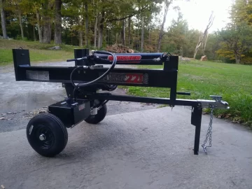

I have owned two electric splitters. My first was one like you are showing, with the cylinder enclosed under the beam. This type does not last very long, they start to leak internally and they really can not be fixed. I would highly recommend an electric that has a traditional hydraulic ram above the beam that can be fixed if it starts to leak. This looks to be the best from my research.
That Swisher is a beast.

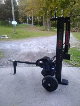

I bought one last fall and it has laughed at everything I've put through it so far, some of it 2' diameter plus. Really nice to be able to split without earplugs and not having to breathe in exhaust fumes. I really like using it in the vertical position for bigger stuff. This is a very high quality, heavy duty machine.
It's in a different price point than the small electric ones though, so not sure if you are looking to spend that much money, but I figured if I bought a gas splitter I'd pay close to the same amount, so why not spend a little more and get the one I really wanted. Felt good to support American workers too since Swisher makes their equipment right here in the US.
