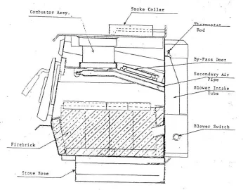

    Chris, did you mean the universal firebrick size of 1.5 x 4.5 x 9 inches or are these all non-standard sized? 1x4x8" would require cutting every brick down to size.
    Just found an old manual for the stove. It looks like this is a hybrid with a secondary air tube and cat combustor. Is that right? Kudos for forward thinking on BK's part.

    I called them today, and the nice lady emailed me a diagram that shows the layout and the cut dimensions.
    Bricks are 9 x 4 1/2".
    Thanks!
