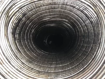

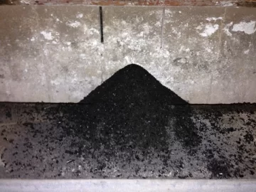

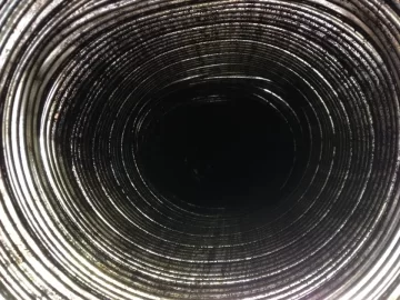

We cleaned ours out Wed. after 2 seasons of use, last season saw some pretty heavy use but had fairly well seasoned wood. Cold weather hit early last season and I didn't clean it. It was our second season using the Century Insert with a 6" stainless liner. I burned a Chimney Sweep log in it at the beginning of last season, I did go on the roof and it had about an 1/16" to 1/8" of build up right at the top where the liner was exposed to the cold air at the beginning of last season. We bought a nylon Rutland brush and rods and cleaned and I have to say we were surprised at how little came out, maybe 2 pints probably less. I wasn't able to remove the liner from the top of the stove so I removed the front secondary air tube and the upper baffles and let it fall into the stove.
Before

After, not much difference.

All that came out.

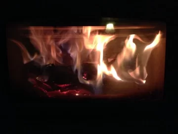

First burn was today
